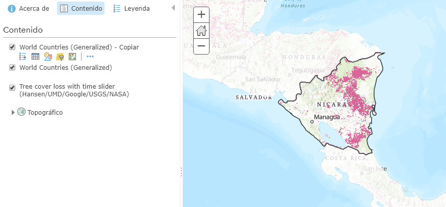

The layer that you refer to, is based on a raster mosaic dataset. You can apply some filtering but as expected the attributes of the mosaic dataset do not contain countries and therefore you will not be able to filter the data on a specific country (images normally don't follow the borders of countries).
As alternative you could add a layer of countries and filter on the country you want (use borders only) and add another layer where the country you are interested in is the only country that does not draw and assign a white fill with little transparency and make it look like this to highlight the country you are interested in:

You could download the relevant TIFF files (is this the list of files: https://storage.googleapis.com/earthenginepartners-hansen/GFC-2016-v1.4/lossyear.txt ), create a mosaic dataset from them and clip the result on your country (in case the steps that I described earlier does not yield an acceptable result).
