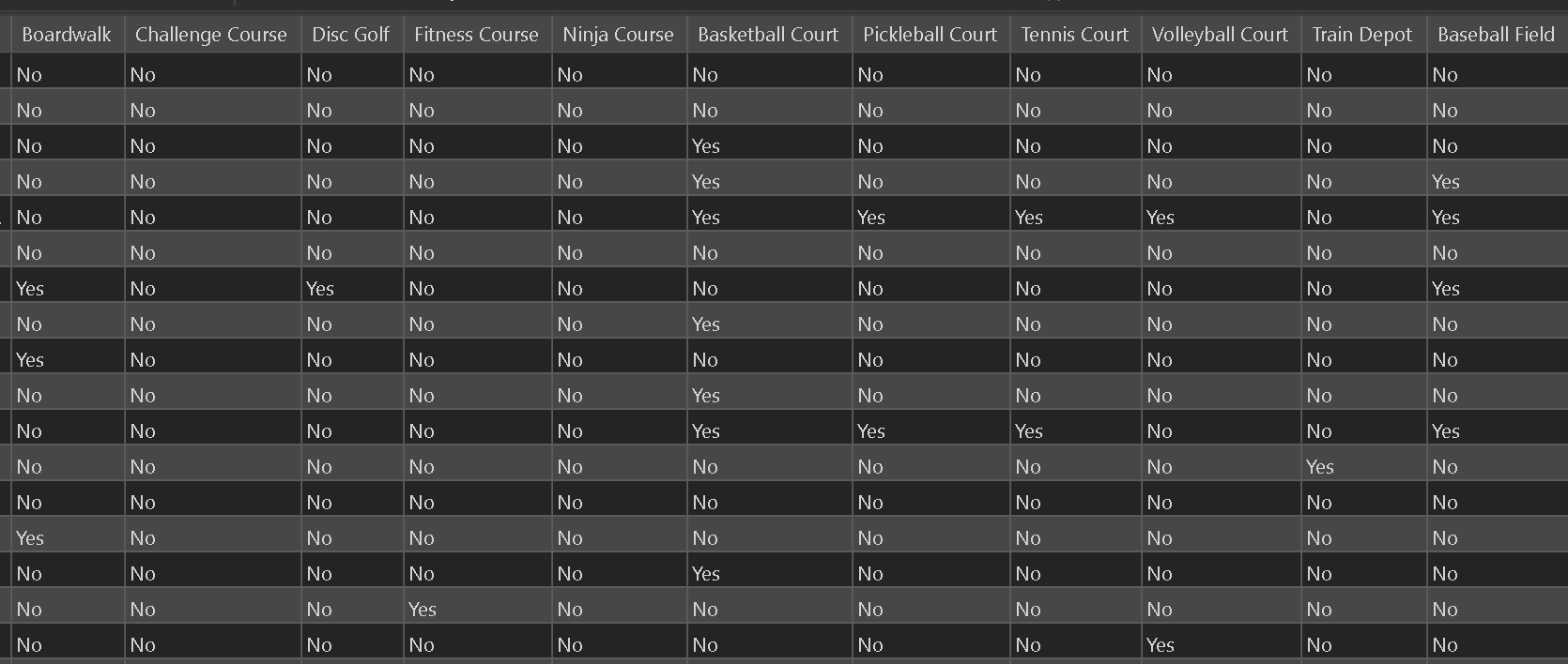

Hello!  I have an AGOL hosted feature layer for park amenities.  Each amenity is in it's own field and each park that has any of the amenities, have been set with a domain of YES or NO.  I hope to be able to have the pop up show a simple list of the amenities that exist at each park but not the amenities that are not.  I then hope for people to be able to search for a park based on the amenities that they are interested in having access to.
I was trying to use a tutorial that I found on YouTube but it didn't work for what I am trying to do.  Any feedback and advice would be greatly appreciated.
Below is an example of what my data table looks like if that is helpful.

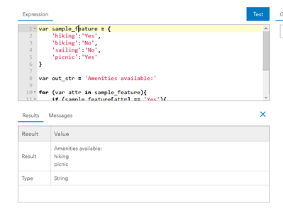

There are a few ways you might tackle this. Considering you want to run a similar check for each attribute, it makes sense to use a loop here. We'll iterate over a feature's attributes, and if the value is "Yes", we'll add it to a string, then return the full string at the end.
var out_str = 'Amenities available:'
for (var attr in $feature){
    if ($feature[attr] == 'Yes'){
        out_str += `\n${attr}`
return out_str
Testing this against a sample feature as follows:
EDIT: I noticed your post referenced a domain. Just be sure that the if condition references the actual value, not the label, so "YES" or 1, or whatever you happen to be using.

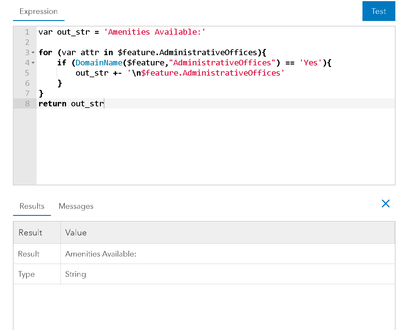

So, this is what I have so far, however I seem to be missing something when it comes to returning the name of the field.  Ignorance is sometimes bliss, but sometimes it's not. 😄

Oh, note that the added string is in backticks, not single quotes. ` instead of '. It's next to the 1 key.
In Arcade, as in JavaScript, a backtick string allows you to access variables and other values within a ${...} inside of the string.
EDIT: You could also do out_str += '\n' + attr. We want to add "attr" to the string, as that will reference the key (the attribute name) as opposed to its value.

hherrmann_coj
So this isn't working for me.  Not sure what I'm doing wrong.  So I tried to do an IF/ELSE statement but that didn't work either.  I am horrible at stuff like this.
