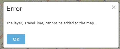

Just last week I was able to create a new map on ArcGIS.com and add data from here:
TravelTime/TravelTime (MapServer)

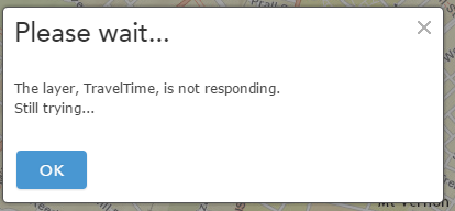

And it created a nice map. Now when I try, I get a "taking a long time to respond" warning followed by an error saying it cannot be added. I don't think I did anything to our ArcServer. I asked a few other AGO users to try and they saw the same results. I rebooted our server. I can add the same service to ArcGIS desktop with no trouble. Finally I tried a completely different server:
Folder: Utilities
It does the same thing. Am I doing something fundamentally wrong or did I break the Internet?

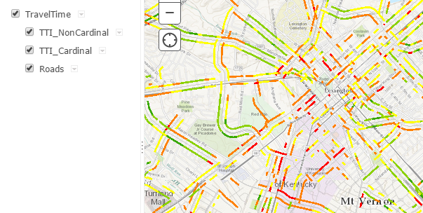

It seems to be drawing just fine:
Is there anything in the logs of your ArcGIS for Server?

I log into arcgis online and create a new map and add the above link (with or without the :6080).  The I see:
For a brief moment this morning, the same steps worked fine (as it did for me a few weeks ago). If anyone can add this layer right now, then it must be something I am doing.

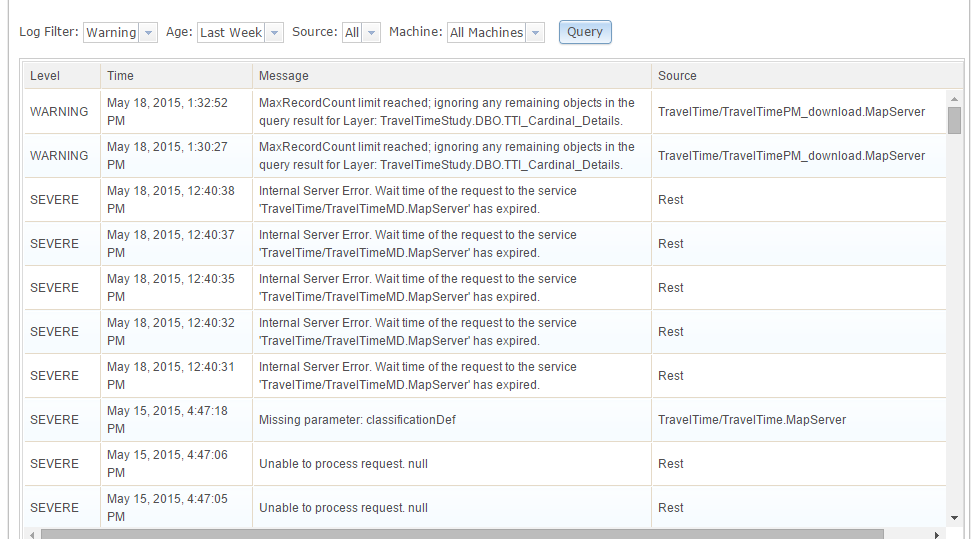

I do see some severe log items:
