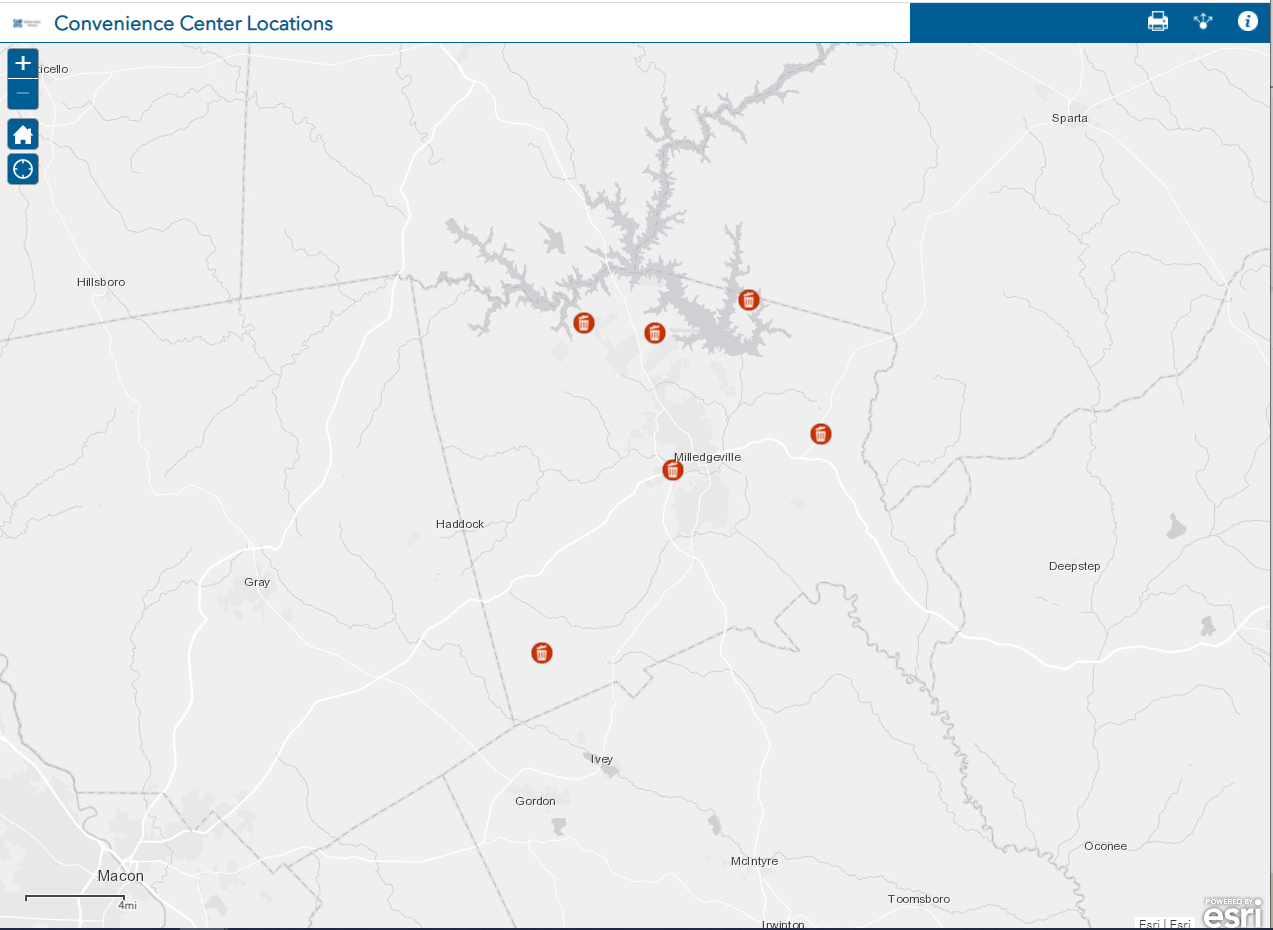

I am trying to center the web-map I created using the the web app model builder; however, whenever our site manager embeds the web-map into the website the default extent is always

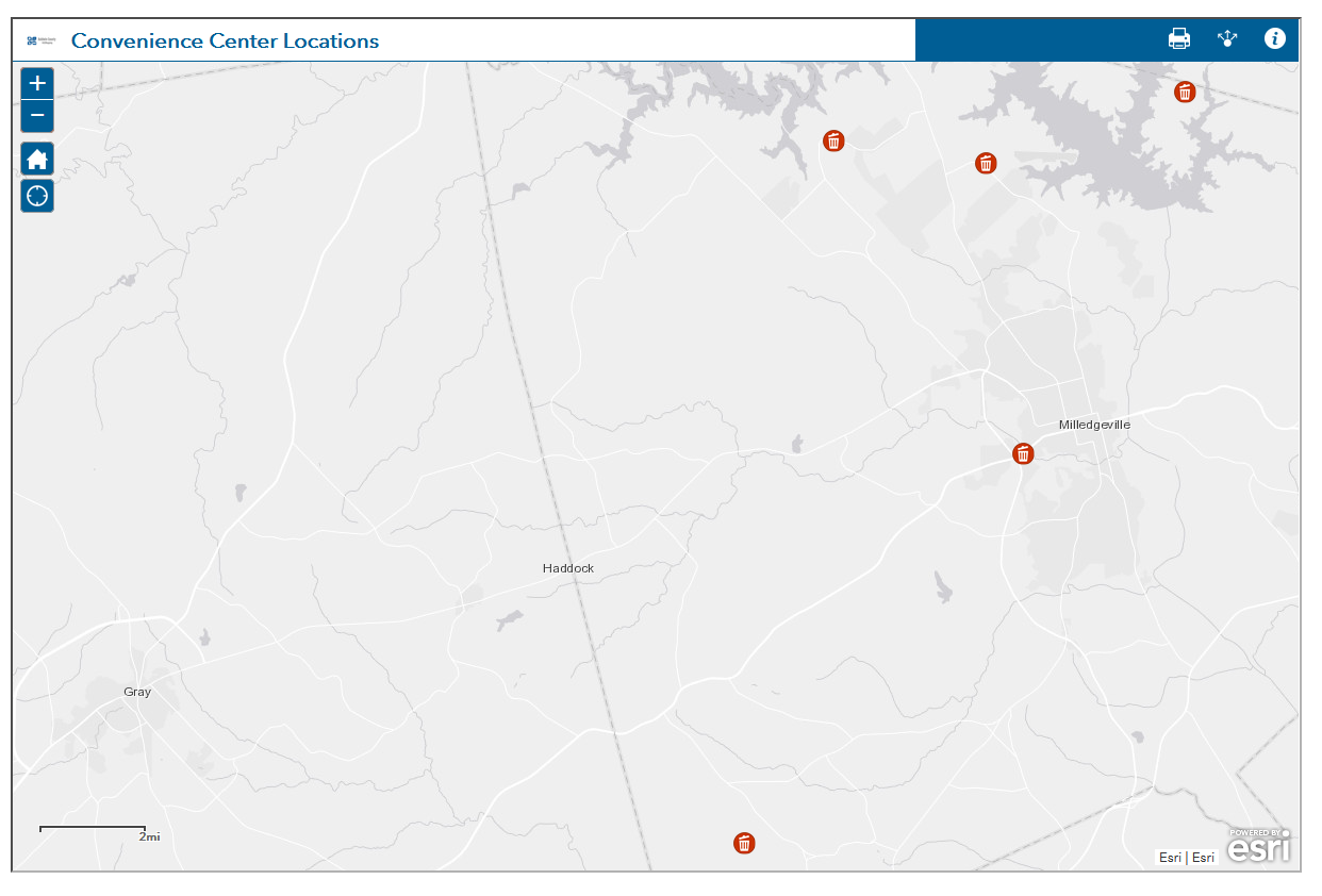

It should look like this
I do not know if its something on my end or if its something one their end. Has anyone come across this issue and know the solution? I have changed the extent multiple times; however it never changes what the default is on the website.
