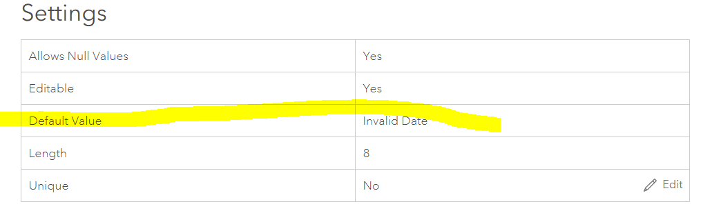

We have a feature service which is published to ArcGIS Online. We didn't specifically set default dates in Pro before publishing.
We noticed that new records had these dates set to 30 Dec 1899.
When we check the field information in ArcGIS Online, we noticed that the "default value" says "Invalid Date". However, if we open up the feature service in Pro and look at it in the Design Fields view, it says the default value is "30 Dec 1899".
What we actually want is for the date to default to a null/undefined value. Can anyone explain a) what is currently going on with the "invalid date" vs "30 dec 1899" confusion, and b) how would we change this to default to null?

So there shouldn't have been any default value, but I double checked the json of the feature service endpoint and noticed that there WAS a defaultValue set for these date fields, all set to:
"defaultValue" : "-2209161600000"
So obviously something has gone wrong in the publishing process. So the next thing I tried was using the updateDefinition api to change the defaultValue, but the defaultValue refuses to update for some reason (even though the response says it was successful). I was able to successfully change other things (such as the field alias) but not the default value for some reason. I wonder if anyone knows why this might be? Is there some reason the api won't update the default value for a date field?
