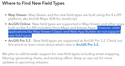

"Date only" is a newer field type that is not supported on the older, JavaScript API 3.x backed Web AppBuilder application.  See more in the blog below.
Time is on Your Side with New Field Types in ArcGIS Online (Oct 25, 2023) - specifically the "Where to Find New Field Types" section
also see Save the Date: Transform Your Data with Date-Only Fields in Map Viewer (Sep 25, 2024)
