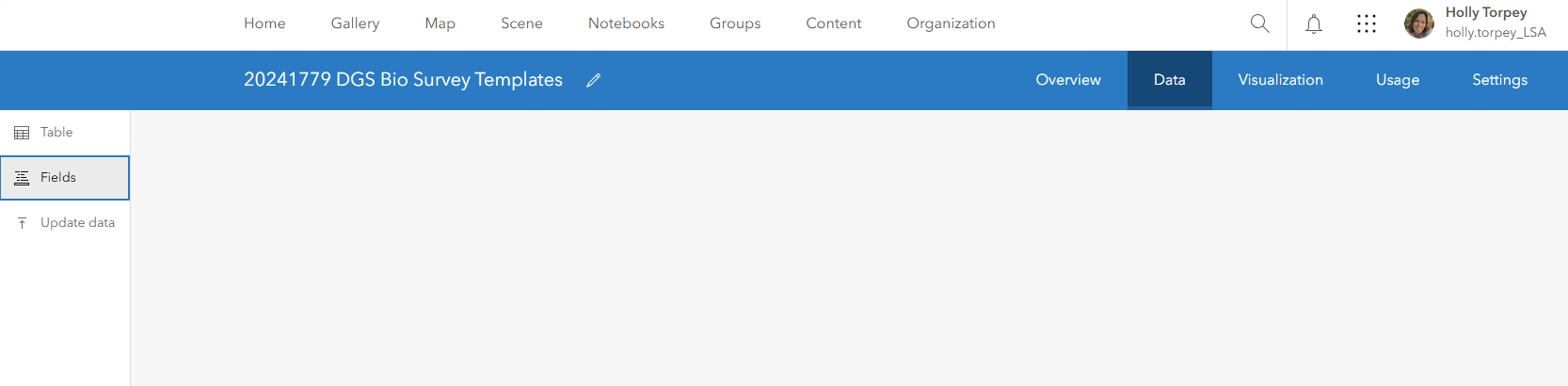

In other words, if I open the Item Details page for a hosted feature service that has multiple layers, and I select one of the layers and then click the Fields option on the left and add a new field, the page doesn't reload properly after the new field is added. I can no longer select a layer and no fields are displayed. Clicking the Table option on the left also doesn't display anything. In fact, the only way to get the data to display again is to reload the browser tab. This is annoying and inefficient when I need to add several fields to the same layer. I have experienced this with two separate feature services since the June 2025 release.

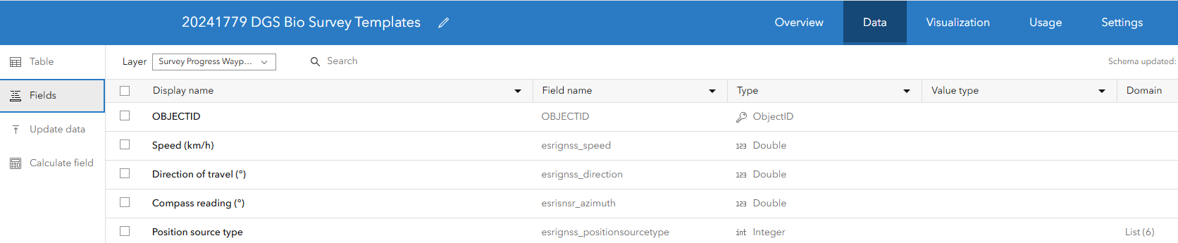

Before adding a field:
After adding a field:

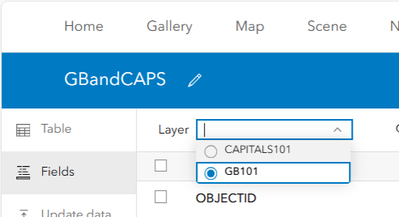

In ArcGIS Online I select View Details on my Feature Layer (hosted) that has 2 layers in it. From the Data tab > Layer pulldown, I select 1 of those layers.

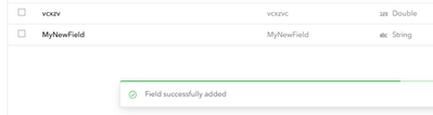

Then from Add field (top right) I add a Text > String field, just giving a Field Name, then Add Field. And my new field is added as expected.
