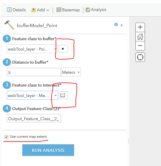

I created several custom geoprocessing tools in Pro and published them to AGOL as web tools. When I go to run them I notice there are what appears to be toggle/action buttons next to two of my parameters. What is their purpose? I have looked for information but maybe I'm not describing them correctly to find an answer. I understand one is related to points and the other is for polygons but what do they do?
Also, can someone explain the check box at the bottom for "Use current map extent"? What is it for and when would you use it? Sorry, these may be dumb questions. I've attached a pic with the items circled in red. Thanks everyone!

The small icon next to the layer indicates if a point, line or polygon layer is required. The selection list only gives those layers that match the requirements.
"Use the current map extent" would apply the tool only to the current extent of your map.
