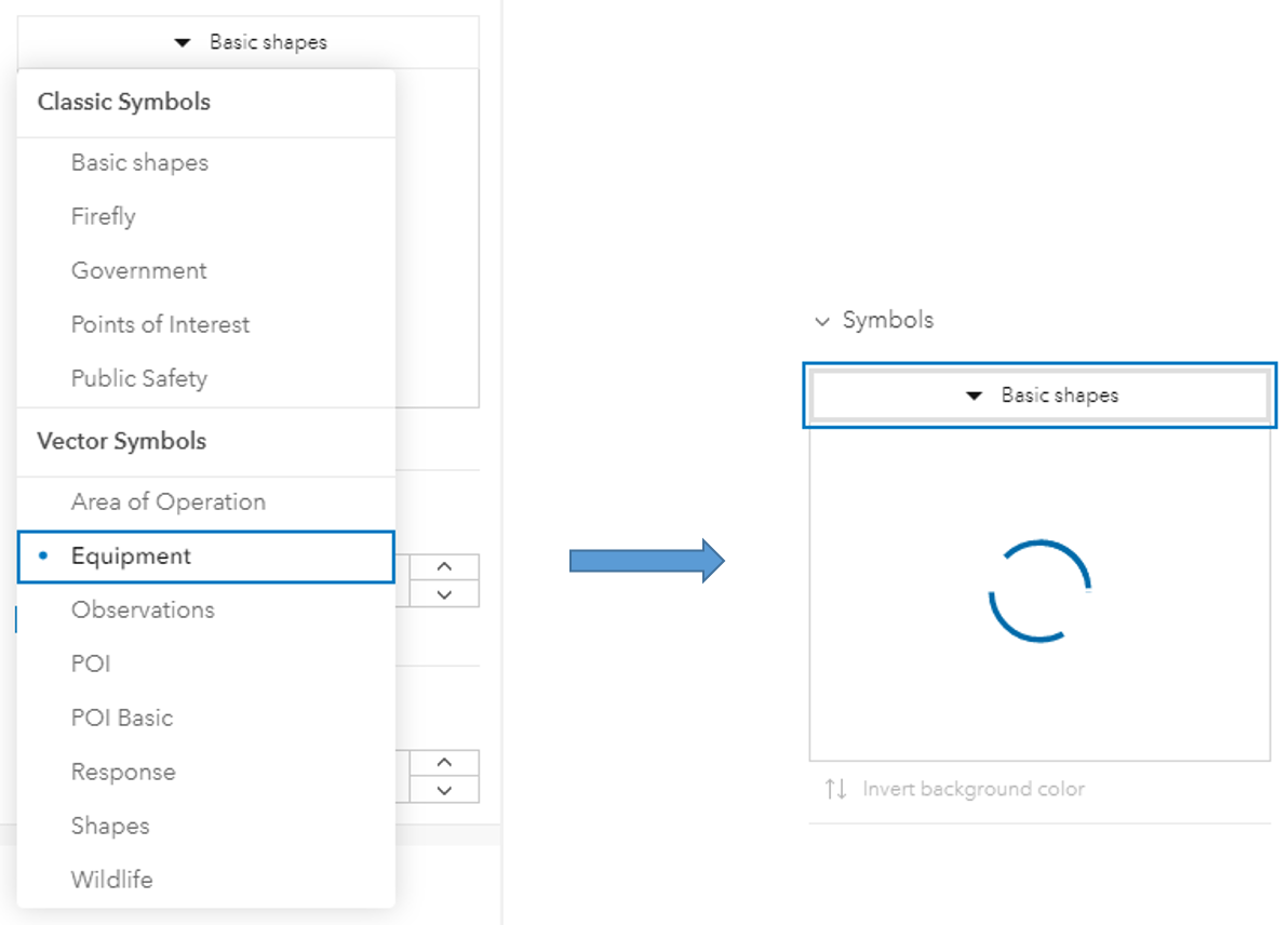

When the current Map Viewer was in Beta, I was able to use custom symbols. Now that it is out of Beta, this no longer works. I can see my symbol styles listed, though when I select one, it endlessly tries to load.
Has there been a change to this functionality from Beta to Production?

This is an issue we are looking into fixing for the next update. Right now switching the style to Everyone will fix the spinner/loading issue you see above.

Thanks for the reply @RussRoberts . Do you have any info on timing for the fix? Sharing with Everyone is not a viable solution for me. Thanks.

We are planning on having this roll out with the Online update coming out in July.
