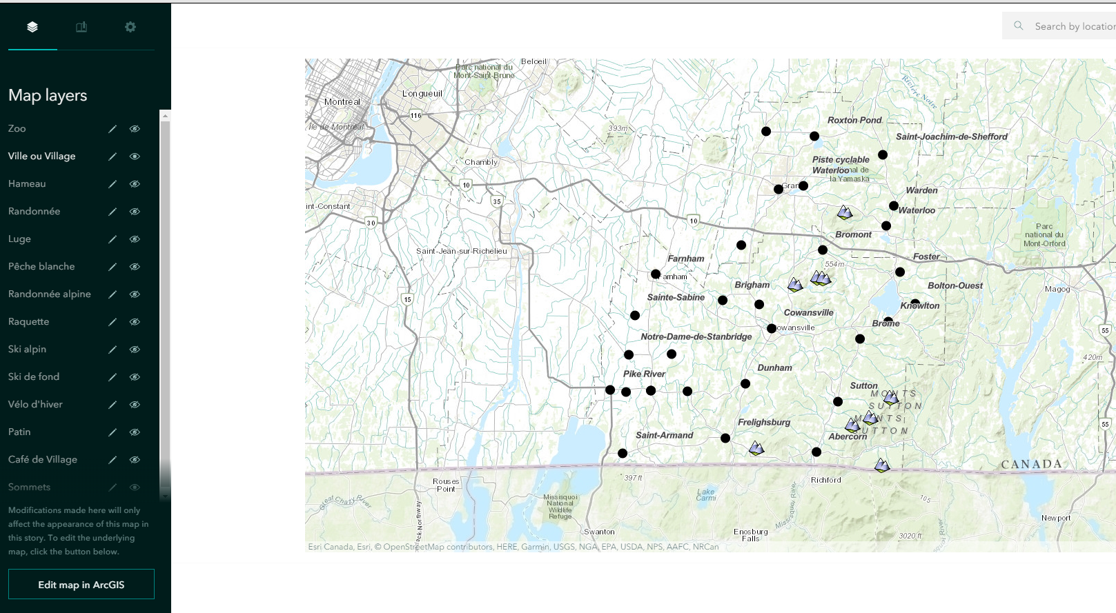

Here's a capture of what is shown in story map:
(mountains are native icon from arcGIS online, black dot are supposed to be something else..)

Hi Pier-Philippe Labrie‌,
ArcGIS StoryMaps uses the 4.13 version of JavaScript API to display the web map as a block in the story prepared in your ArcGIS web map viewer (which uses the 3.31 version of Javascript API). At the moment, this is a known issue that the custom PNG that you're using is failing to be fetched from the resource.
If you want to show case the map with the custom picture marker, you can choose to add the map as an embed block by using the <iframe> such as below:
<iframe width="500" height="400" frameborder="0" scrolling="no" marginheight="0" marginwidth="0" tit...
(You'll have to turn on the Village layer on the map and save it to view this in the story).
You can add this embed as a regular block or embed this map in a Sidecar media panel.
