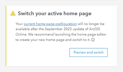

It looks like it's loading legacyHomePage.html. Have you officially switched your homepage in the org settings?

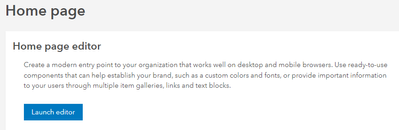

We only started with ArcGIS in July 2021 so I didn't think we had a legacy homepage. If I click Homepage under Settings I just get a link to the home page editor.
I think the problem only occurred after I started configuring the homepage with the editor (though I'm not 100% sure because we haven't been directing public users to the homepage yet and I'm usually signed in.)

Thanks for your advice so far, Josh. I've read this article and it says 'All ArcGIS Online organizations created after June 30, 2020 only have the new home page, so they don’t need to transition.'
Let’s transition to the new ArcGIS Online home page (esri.com)
Do you think I should create a new question asking why our homepage is loading legacyHomePage.html?
