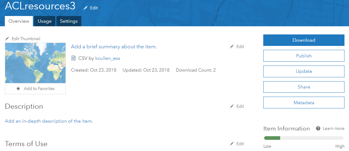

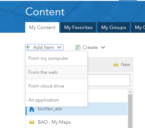

I downloaded your CSV and then did the following and it published all the data and features drew as expected:
1. Go to Content page and click add item > from computer
2. Checked the box to publish this file as a hosted layer
3. Radio button for locate features set to > Coordinates
4. When I clicked add item the hosted feature layer was published and all the data is available in the table and features draw as expected.
If you have already uploaded the CSV you can navigate to the item details page and click publish and then following this same workflow.
