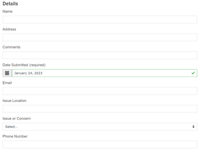

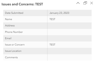

I have created a Crowdsource Reporter app and have everything loaded and working.  However, the form has fields in a different order than how they are in the Feature Layer.  I have configured the pop-up to show the fields in the correct order, and ensured that only the fields I want shown are editable.  The pop-up in the map shows the fields in the correct order, but it is not carrying over to the form.
Can anyone offer insight as to why this change isn't carrying over to the form?  Thank you!
JasminePrater
On a whim, I decided to open the web map in Map Viewer Classic and configure the pop-up there.  The reorganization of the form showed up immediately.  The form did not revert after I made changes in the new Map Viewer, so configuring it once in Map Viewer Classic seems to be enough to force the update.
