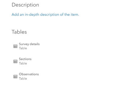

I have a Survey123 form that collects data into a feature layer that contains 3 related tables.
In order to create summaries, reports and analysis on the data, I need to be able to join all tables together.
Is it possible to create layer views joining more than 2 tables? If not, this seems like a major limitation if Arconline allows me to create the tables in the first place.

No, you cannot create a joined layer that flattens your tables. Well, you can with two, but not more than that.
We get around this by using Data Expressions to flatten the data, but that would only be of use in a Dashboard, really.
