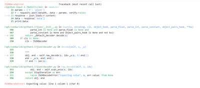

LindaSlattery
OK, so I did that and got the following error. Sorry for the screen shot, but whenever I copied and pasted I got an error in here. Just my lucky day with errors 🙂
JakeSkinner
Esri Esteemed Contributor
@LindaSlattery did you update the dataURL variable with the correct URL including the token?
LindaSlattery
Yes, with the API key. I can put the URL into a browser window and the data gets returned, so the URL is correct.
