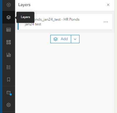

The first option above doesn't seem to work for me, as it says there are no related records available and i should create them in ArcGIS Pro. However as shown in the screenshot below, the relates do exist in arcpro:

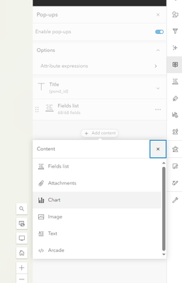

The second option doesn't seem to work either as i don t have the option to add rel;ated records in the pop ups pane:

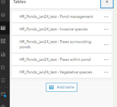

Just to clarify my set up, I have my layer and 5 tables as shown below:
