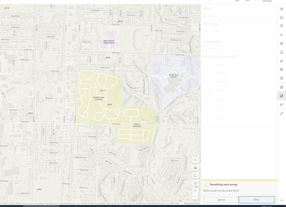

Thank you Emily but I keep getting this error whenever I try to save it errorQuestion.PNGerrorQuestion.PNG
