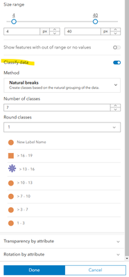

In Map Viewer you can use classify under the Counts & Amounts (size) style.  Its located between the Size range slider and Transparency by attribute sections of the panel. From there you can set the number of classes, labels for the set classes and pick/configure your symbols for the classes. LMK if you have any further questions or if you want me to check out your map.

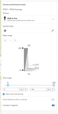

Hey there! I'm having a similar issue with not being able to find the classify option in order to add custom breaks. I'm using the Counts & Amounts (size) style in the new map viewer, but do not have the 'Classify data' toggle. What do I have wrong?
