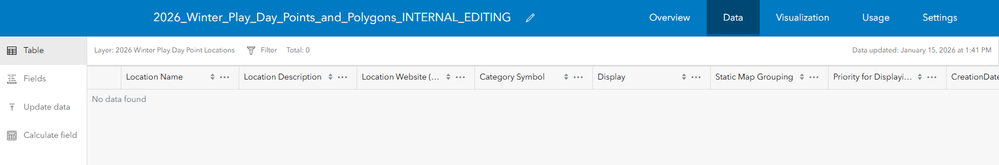

I am trying to copy a hosted feature layer. The layer is owned by another member of my organization, we are both administrators within our organization.
the original hosted feature layerthe original hosted feature layer

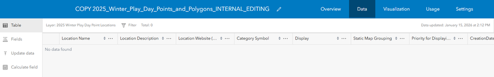

I have tried:
Both methods have resulted in "no data" in the copied layer.

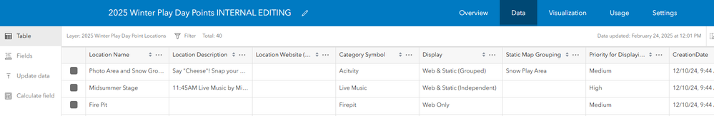

my copymy copycopy created by the data ownercopy created by the data owner
The data owner also tried copying the layer into a new hosted feature layer and also resulted in no data. Is copying features currently broken or is there a step we are missing?

Hi @Meredith_Keraga , Thank you for posting the question! I tested the workflow at my end (exporting as a Feature collection > Public the Feature collection as a Hosted feature layer), and I do not reproduce the same issue.
  • Is the behavior specific to any item?
  • Have you tried exporting the data in a different format, for example, as a File geodatabase >> Publish to confirm if it reproduces?
