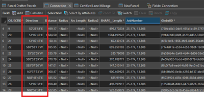

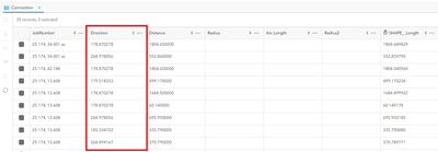

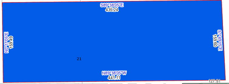

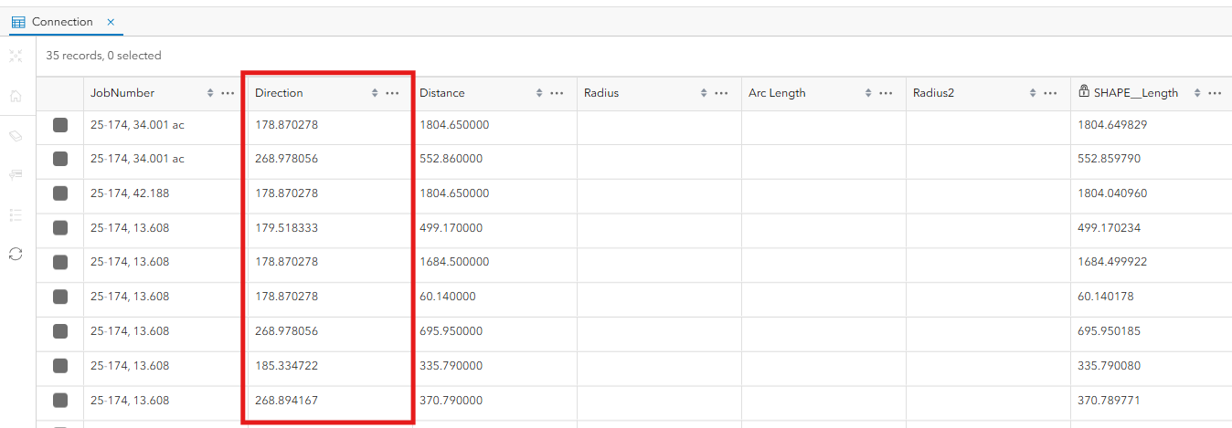

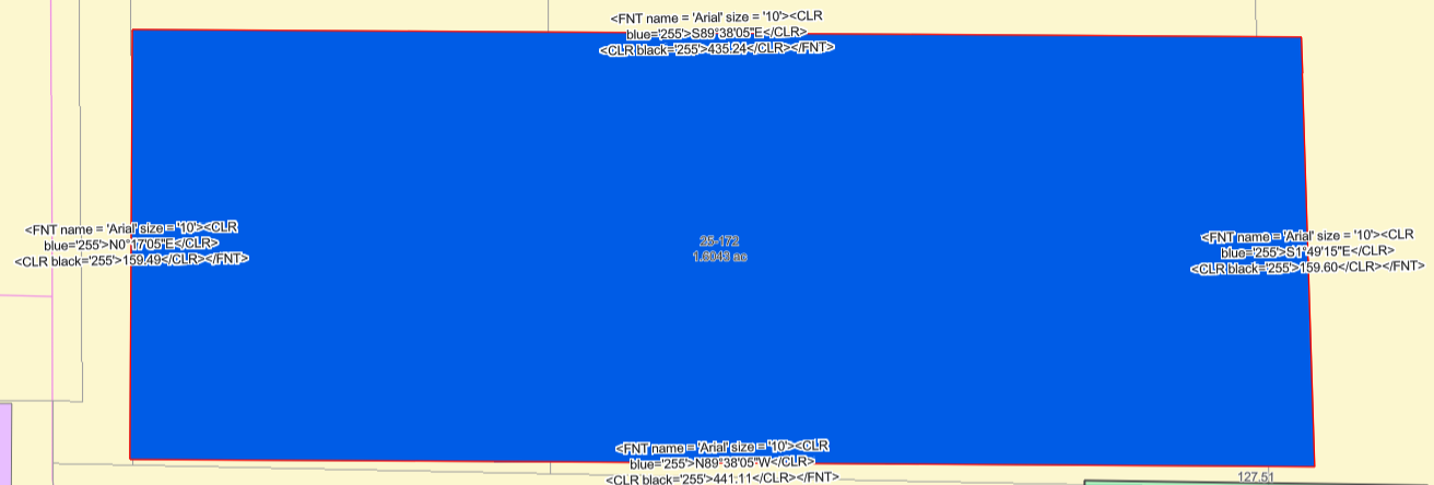

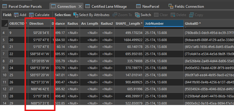

I'm working with the traverse editor in acrpro to check for closures. When I share it online the Direction field changes from dms, breaking the labels. Is there a way I could reverse this? The labels were made automatically by arcpro using this expression:

Labels in web maps aren't able to render the formatting tags with Arcade. I think the only solution would be to set up a label class for each of the different colors used in your labels.
