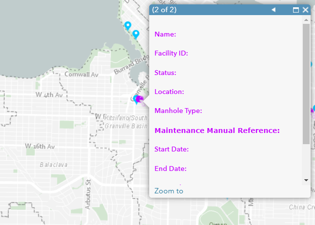

I created a map in ArcGIS Pro, which I have then utilized to Publish a Web Layer, but am having issues with my custom Configured Pop-ups.
In my web map when I identify a feature, the attribute information is missing as seen below:

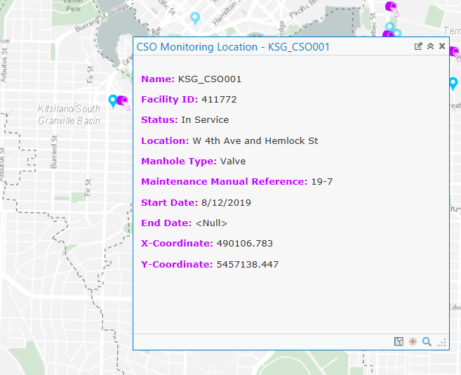

But, when I identify that same feature in ArcGIS Pro, it displays as desired:

Hello Brian,
Can you share a screenshot of the configuration window for your popups in the webmap viewer?

TylerBurns
Strange-- It seems like the popup is configured with the correct attribute expression to pull the values from the fields with Arcade.
Can you test and see if the attribute information is able to be displayed successfully if you toggle the 'Display' setting to "A list of field attributes", rather than "A custom expression"?
