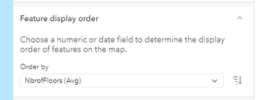

Is this for disapplying sort order?  The Map Viewer has this but is only available on one field.

Good to know about the map viewer, but I really need to change the sort order of the raw data in the hosted layer. I'm consuming the layer in a non-esri app. The customer noticed that the data is not sorted in that app and asked if I can configure it to be sorted. That app lacks a capability for sorting as well.

Yup this isnt on the service level and is driven by the API https://developers.arcgis.com/javascript/latest/sample-code/layers-feature-sort-order/
