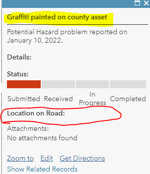

So I would like to add the locroad field and formatting preferably above the Resolved On field and only show it when it meets this expression:
When I added your suggested HTML modified with my expression:
<div style="display:{expression/expr5}"><b>Location on Road:</b> {locroad}</div>

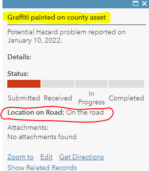

It adds the locroad field, but is not hiding it based on the conditional expression. For example it is showing it for another probtype = Graffiti painted on a county asset. This is a condition when I would like to hide it:

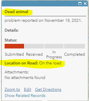

This is the correct behavior for Dead animal and the only case when I want Location on Road: <domain value> to show in the pop up. For any other domain value I don't want to show it.

 I would like to add the field locroad and formatting. I only want locroad to show if the probtype == "Dead animal" If not, I do not want locroad to show.
I created an expression DeadAnimal[expression/expr5) for the condition:
$feature.probtype == "Dead animal";
 Then I simply modified and added your HTML idea:
<div style="display:{expression/expr5}">{locroad}</div>
 While this added the locroad to the pop up, it is not evaluating the expression showing the locroad field and formatting for a probtype that is not "Dead animal"In this case I do not want the locroad field to show because it is a different porbtype (Graffiti painted on county asset)
I hope this provides some clarification.
