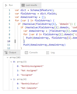

You can use the Schema function to get the domain information for all the fields. This code gives you an array of an array of the fields and their codedValue domain names.
var dict = Schema($feature);
var fieldsArray = dict.fields;
var domainsArray = [];
for (var i in fieldsArray) {
  if (HasValue(fieldsArray[i], 'domain')) {
    if (HasValue(fieldsArray[i].domain, 'codedValues')) {
      var domainArray = [fieldsArray[i].name]
      for (var d in fieldsArray[i].domain['codedValues']) {
        Push(domainArray, fieldsArray[i].domain['codedValues'][d].name)
      Push(domainsArray,domainArray)
return domainsArray
return domainsArray

That worked perfectly. Thanks for the help!
