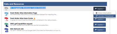

You can not extract/download the features from the given map service.
You can download an offline version of data from https://catalogue.data.gov.bc.ca/dataset/4483aeea-df26-4b83-a565-934c769e74de#edc-pow > BC Geographic Warehouse Custom Download
