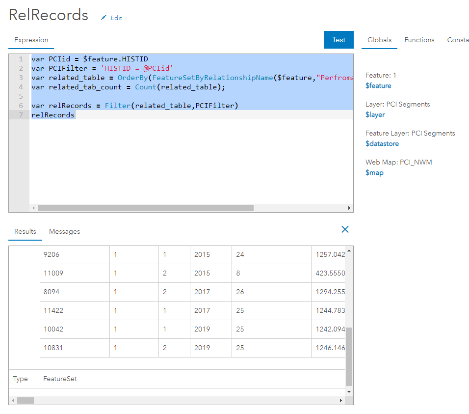

is it possible to add a chart to a webmap (new webmap) popup using an Arcade featureSet? I have a feature layer with a related table (1-M) and I would like to be able to use a bar chart to show data from previous years.
The arcade expression returns the featureSet as expected (see image below)... can it be done?
Thanks!

YEEEEES!!!
I knew I saw it before... Thanks for helping.
Now, I don't see in the Chart Template any options for showing the "data label" and Category label like you could using the Configuration Chart... Am I missing something or it's a limitation of the template?

this isn't supported on charts in popup yet.
