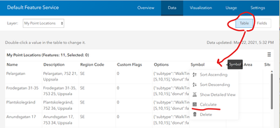

Here is where you add a field:
Click the field name and choose calculate:
If the integer type is okay you could also just choose to not show thousand separators in you pop-up. That you can configure in the web map from the fields symbol:
