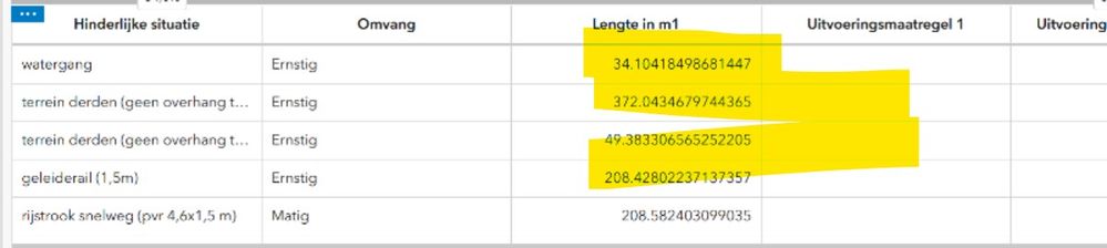

I cannot figure it out where to change it for the whole field (NOT using calculate field)I found this article: https://doc.arcgis.com/en/dashboards/latest/get-started/format-numbers.htm
But I cannot find the Formatting settings for the table.

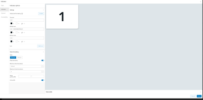

The link you shared is a setting within Dashboards, if you select a gauge, serial chart, indicator and a table you will find this setting somewhere around here.
If you want to have less Significant digits in the table, try this in the Visualization pane.

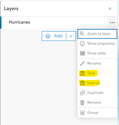

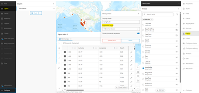

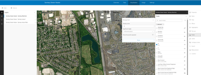

Hi @PeterGoedbloedd , you can specify the number of decimal places for a feature layer both from Map viewer and Visualization page by:
