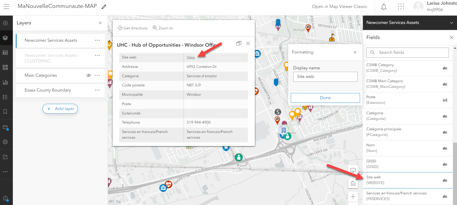

Hello,

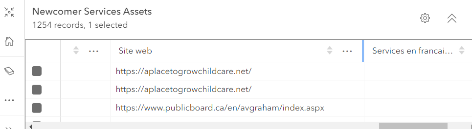

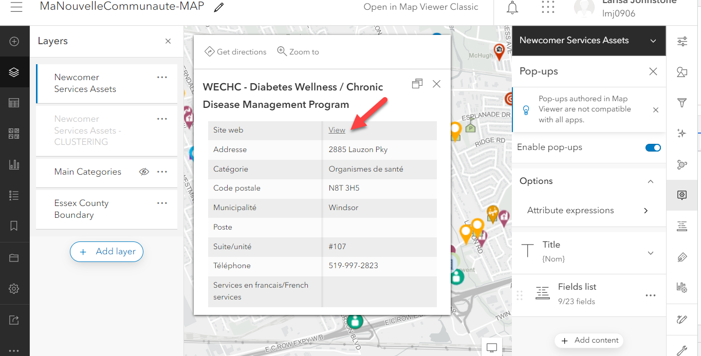

Does anyone know how I can change the value "view" to something else in the pop up in my Map Viewer. This word is actually a link to the url for websites that are in my dataset. The thing is , my dataset has the full url in the field and the field name is called out as "SITE WEB". When it populates the data, it just defaults to the word "view" and is linked to the url.  (see the screen shot below)
Is there anyway I can change that word? I have a French Site that I am developing. And no, it is not related to my browser language...tried that already. lol! Hope this makes sense.
Thanks
Larisa
BernSzukalski
Esri Frequent Contributor
You're currently displaying the default for a pop-up which is the list of fields. You could just create a text block to display what you want. For the hyperlink, you can use any words and then add the link. These blog articles might help you get started.

Thank you so much, this is exactly what I was looking for. 🙂
