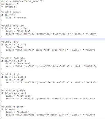

In my pop-up, I'd like to have the text correspond with the map symbology color. Any suggestions on how to do so? I tried the following below with no success:

dwold
@KenBuja do you see anything I am missing in the code?
this my pop-up:

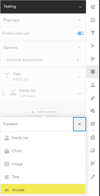

KenBuja
MVP Esteemed Contributor
You have to add this code to a Arcade element

KenBuja
