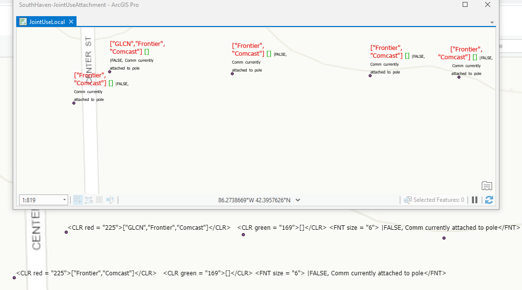

Hello All,
I am trying to format web service so that labels are displayed correctly in ArcOnline. The image below has two windows, where top-floating window and bottom window are ArcPro and ArcOnline, respectively. I pasted Label expression used below picture.
Thanks!!!
-Alexander

PeterMilenkovic
Hi Alexander,
Looks like I am also having a similar issue. I am trying to publish a referenced web layer to my portal from arcgis pro, and some of the formating is dropped.
ArcGIS Pro
Portal
I have been successful publishing from ArcGIS pro to ArcGIS Server (as a map service, no portal is installed on that server), so i wonder if this is a bug in Portal/ArcGIS online?
Peter
