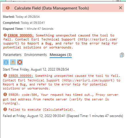

  • I have tried joining the new data table to the hosted feature service in ArcGIS Pro and using the field calculator, and I keep receiving the below error. I have tried to mess around with the feature service settings in AGOL, turning editing on, turning editing off, turning delete protection off, etc. and nothing works or allows me to complete the field calculator process to update the attribute data.
