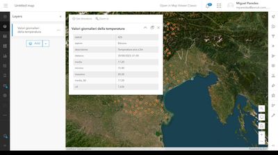

Thank you for requesting the change.  I can confirm that I now have access to the Geoserver service from Arpav.
As a result, I have added the WFS to the Content in ArcGIS Online, and then viewed the layer Vaolri giornalieri della temperature in Map Viewer:
If I am not mistaken, updates to the service should pull through since the service is being added directly.

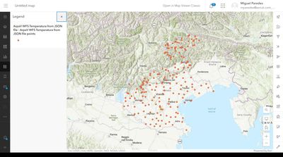

You could pull the layer as JSON with the URL https://gaia.arpa.veneto.it/geoserver/ows?service=WFS&version=2.0.0&request=GetFeature&typename=geon... save the output to a file and then create a service from it, but it will be a static feature layer:
So my recommendation would be to use the WFS.
