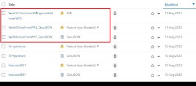

With respect to the GeoJSON files you provided, I was able to add them to Content in ArcGIS Online and then to the Map Viewer:
Since I do not have access to the service you are using, I decided to enable the WFS capabilities in an ArcGIS Server 10.9.1 Sample World Cities default service and try if I would be able to add the GeoJSON and KML links into ArcGIS Online, so:
https://<server>.<domain>/server/services/SampleWorldCities/MapServer/WFSServer?request=GetFeature&s...srs=EPSG:4326&outputformat=GEOJSON
and
https://<server>.<domain>/server/services/SampleWorldCities/MapServer/WFSServer?request=GetFeature&s...KML
I was able to add both services to the Content using the +Add item > URL

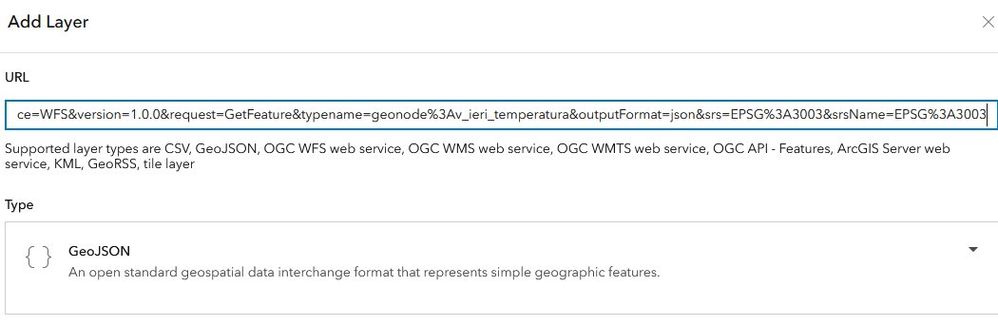

Interestingly, when I checked the GeoServer guide for WFS 2.0.0 for GetFeature I found that the parameter for specifying the CRS is srsName.  In the Esri WFS, it is srs only.  I would suggest trying the URL again but with only srsName, committing the srs parameter:
https://gaia.arpa.veneto.it/geoserver/ows?service=WFS&version=2.0.0&request=GetFeature&typename=geonode:v_ieri_temperatura&outputFormat=json&srsName=EPSG:3003
Hopefully, that will work for you.

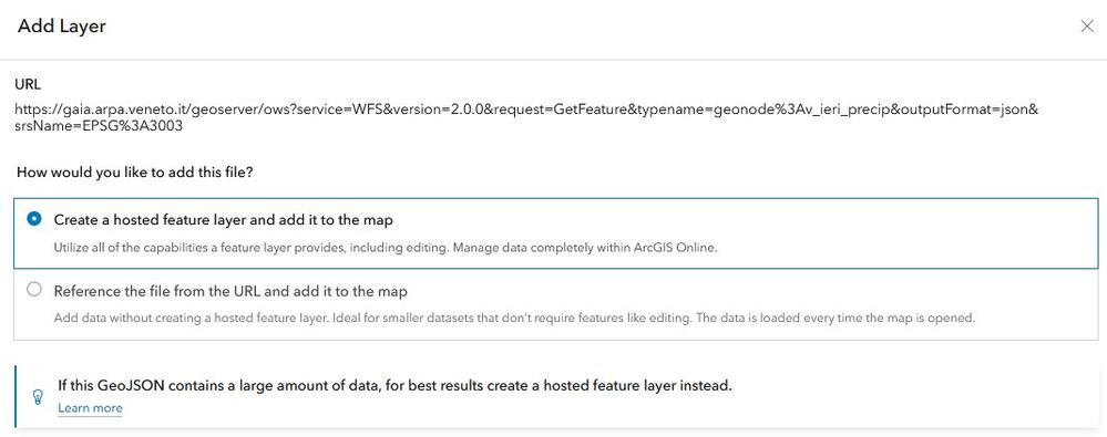

You're right @MiguelParedes! It seems that in ArcGIS Online we should only use the srsName parameter, without the srs one, when we load WFS URLs...
I was able to load the JSON in ArcGIS Online, but only as hosted feature layer and not directly form the URL:
If I try Reference the file from the URL and add it to the map I receive this error:
Now I have to understand if the hosted feature layer I created will update automatically, when, daily, the Agency updates the data. This because my aim is to create a map and a dashboard which uses the daily updated data...
I postpone marking your last answer as a solution, waiting to check if the data in the hosted feature layer update daily.
