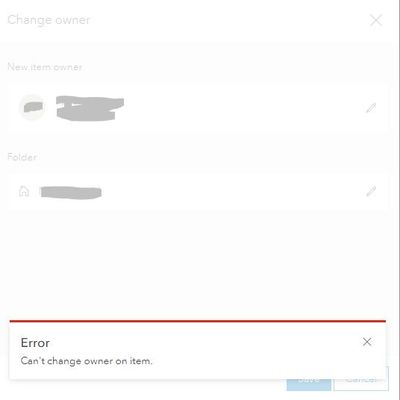

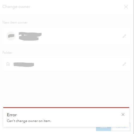

JACooper
This was also an issue for me. On the advice of this solution, I opened an ESRI support case (#03735411) as well. My issue was two-fold: I couldn't change item ownership, but I also couldn't view the item details page; it perpetually was in a loading state and never finished. ESRI tech support was able to fix the case (with help from cases mentioned here), and I got the following notes:
We just had to change some of the permissions and statuses of some folders related to the old source user which were causing issues for the reassign. After we corrected the folders and pathways for the item, it could be successfully transferred to your username's account.
