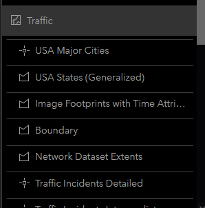

jcarlson
MVP Esteemed Contributor
Your selector is pointed at the layer itself, not the map's layer? It really shouldn't matter, as I'm able to have a selector act against any other layer in the dashboard, map or not.
Try recreating the selector, but choose the map layer as the source layer for its values.
