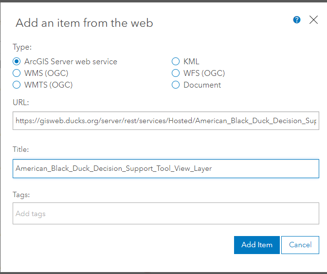

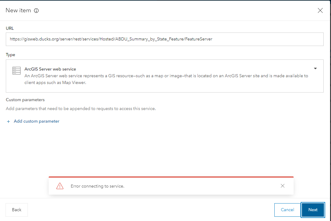

I'm trying to share a feature service from our ArcGIS Portal to ArcOnline. The feature service is shared to everyone on Portal. Previously, we just used the "Add an Item" tool (this tool still on our Portal) and everything worked just fine. Apparently today the "Add an Item" tool has been updated, but it doesn't seem to work. My issues:
1) What is a custom parameter and why is it important?
2) Am I doing something wrong or is this a bug?
3) Can you please provide more documentation for this new item tool?previous_system.pngnew_system.png

I can confirm that I see this error as well, connecting to other services. And it does appear to be an issue with the new tool.

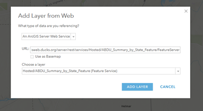

For now, you can still add layers from a URL in the map viewer itself, then save it as a content item from there.

Hi @JesSkillman and @jcarlson - I am able to reproduce the issue with services from this Enterprise deployment but not others (SampleServer6, an in-house 10.9 federated environment). It looks like the tool tries to find /MapServer, which is a nonexistent endpoint for hosted feature layers, then fails. I'm going to report this to our Development teams, it looks like a bug to me. Please let me know and I can create a support case for you so we can track this more closely and investigate further as needed. Thanks!
