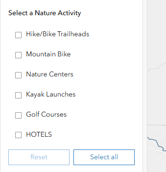

AmySnelgrove1
I have a category selector that allows you to select between various nature activities (in different layers).  When I select an activity in the category selector, the features appear in the map.
The category selector uses a field that is similar between all the feature classes/layers for nature activities. When I select kayak launches to appear in the map, I want the live stream gauge data to appear.  My issue is that I can't add that field to the stream gauge data because it loses its "liveliness".  Grouping stream gauge and kayak launch layers didn't work. Is there a way to get the live stream gauge data to appear in the map when you select Kayak launches? I've tried Grouping launches to the live data, but that didn't work.  I hope that's clearer.
