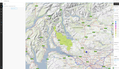

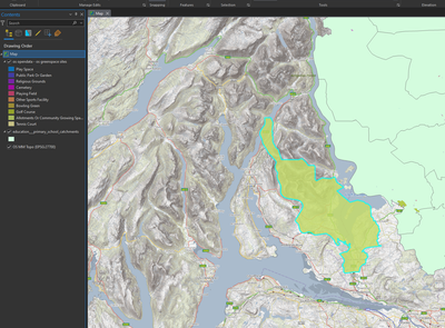

Absolutely you can, the screen shot below is taken from local to AGOL just now.
What's your process of copy/paste? Are you copying your feature then using Paste Special or just the CTRL-C / CTRL-V? Also, forgive me, are you saving those edits and is the hosted layer enabled for you to edit?
Pro
AGOL that's copying a polygon from a catchment dataset and pasting it into a different AGOL polygon dataset.
