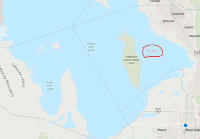

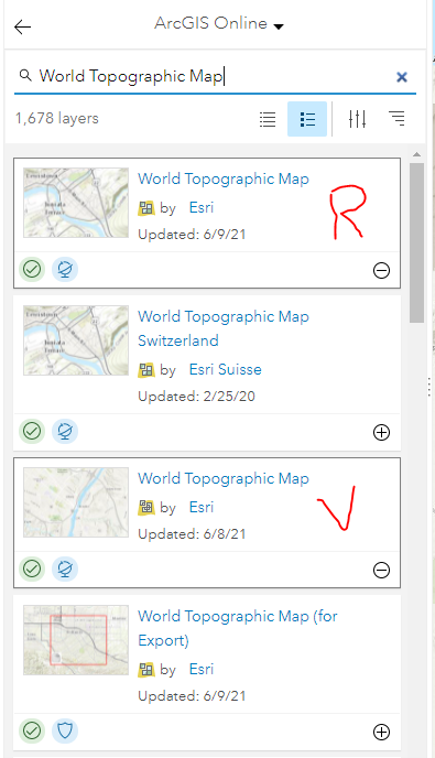

I would love a better way to tell the raster from the vector basemaps.  They both look the same in a search and the raster one actually has a newer date.
The little yellow symbols are slightly different but when you hover over them they both just say Tile Layer.  If it said Vector Tile layer in that little popup or better yet in the title that would help us find the right one a lot.
Unless I am missing a way?  I usually either check description, which is still a bit vague on how to tell, or I zoom into the Great Salt lake which is slightly diff in the vector.

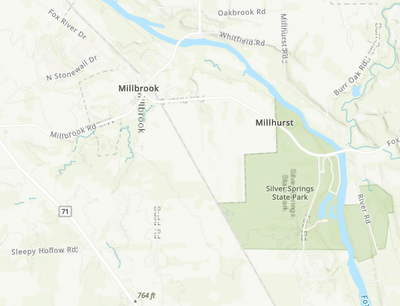

In the new map viewer, an easy check is to rotate the map, as vector labels should orient to the view.
Of course, you have to add them to your map to see that. The descriptions ought to show something about it being a vector tile layer prominently enough, but I haven't checked all of them.
That said, I think it would be nice if there were something on the thumbnail that indicated this, even just a V or R after the title? Even the tooltip for the item type just says "Tile Layer". Not that clicking into the details is that much more work, but if we can eliminate 2-4 more clicks just by adding a single letter to the item's title, that seems like it would be an easy win.

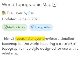

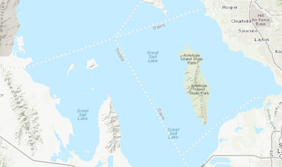

Yea the vector does say it but raster does not.
For me I zoom into Salt Lake
Raster
Vector

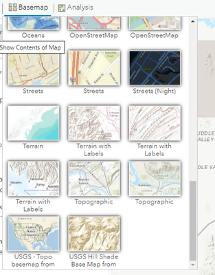

Oh and vector topo map has no actual topo lines?  That may be a deal breaker for us.
Since I am forcing in a new basemap hillshade was not coming with.  Hillshade is still raster so for a topo to look good you will need to use raster anyway.

The admin turned the vector basemaps back on and now they both show with exactly the same name.  A way to tell them apart would be great, not sure what the official way is.
