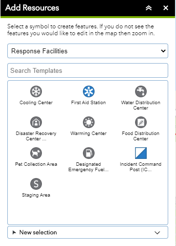

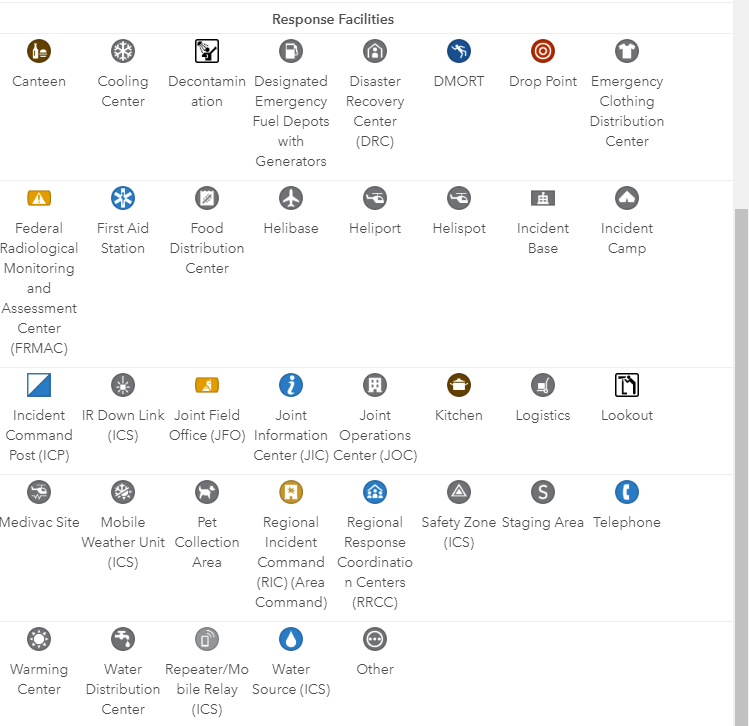

I have a feature class for Response Facilities that I've symbolized into 37 categories.
However, the Smart Editor only allows users to choose 10 categories when creating new features.
Is there a way to allow more than 10, preferably at least 37 feature templates to the Smart Editor?

JoshSaad
Thanks.  I found that even though all the templates were listed in the map, they weren't all being displayed in the Smart Editor.  I tried changing the properties of one of the templates, and they all appeared in the Smart Editor.
CynthiaKozma
I am having the same problem.  I have added more symbols to my feature layer and they show up in the legend - every where but on the template.  Did you ever get yours to work?
