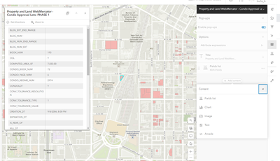

Hi,
I'm trying to show related records in a pop-up.  According to this blog ( https://www.esri.com/arcgis-blog/products/arcgis-online/mapping/rolling-out-related-records-in-map... ) article, I should be able to do this, but for some reason I do not have the option to "Add Content - Related Records".  See screenshot below.  Can anyone explain what might be going wrong here??
Here are the details on the webservice I am using.  I can view the features, and modify the features fields in the pop-up.  Just no access to the related table for some reason.

Thanks @KenBuja .
So just trying the first one in the list, I am still unable to add the "Related Records" (see screenshot below).  I am in AGOL.  I should be able to, shouldn't I??  Looking at the REST, there appears to be 3 related tables but I don't seem to have an option for any of them.
KenBuja
MVP Esteemed Contributor
This is an older server, running on 10.91. From what others in the thread have said, that capability isn't available yet on Enterprise servers until 11.2 is released.
