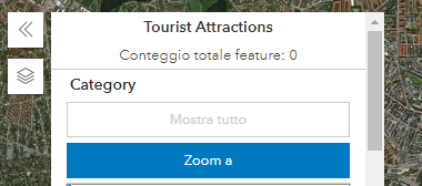

PieroPeppucci
Hi Peter,
sometimes, when i see the interactive legend, the "tourist attractions" give me 0 features, instead of give me the total beacuse the zoom includes everyone.
In your opinion is only a problem of loading or some particular developer issue?
Do you see something strange?
Thanks for your support.
by Anonymous User
Not applicable
Hi @PieroPeppucci - I tried to access the old app link earlier in the thread and am prompted to sign in. Can you share the app publicly so I can take a look and link the URL?
