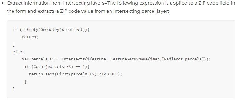

I tried to configure my form to automatically fill in a field from an intersecting layer using the code from this article on configuring forms for attribute editing.

This is a screenshot of the example code from the ArcGIS Online Resources:

You don't need to use Text on a field that's already text. I would guess that in the example given, the ZIP code was a numeric field. But that's not really the issue.
