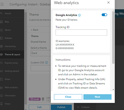

PatrickMcKinney99
I discovered that the Basic and Sidebar Instant Apps allow users to add their Google Analytics code.  I'm not sure if this extends to all Instant Apps or not.
