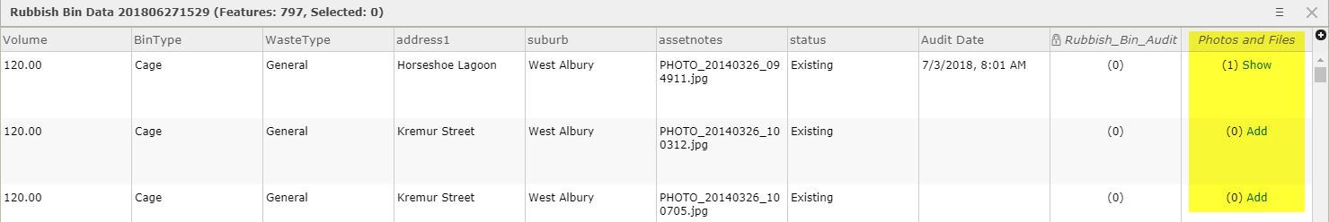

Hey All,
I have created a Web Map using ArcGIS Online, and I have been collecting features using the collector map, and I would now love to symbolize or create a label showing which features have a photo attached.
It seems the field Photos and Files is not available in the filter window, and same when I try to symbolize.
But basically I would love for my points to be a tiny dot if it has a photo attached, otherwise I would like the point to stand out to the user, indicating it needs attention.
Has anyone worked out how to symbolize OR label based on Photos and Files field?
Cheers

Yeah so if I could simply have a label at each feature, and that label shows the number of attachments that feature has associated to it.
In addition to this, could I highlight all my features as Red Dots, then as soon as someone has attached/collected a photograph that symbology changes to green, indicating this feature has been tended too.
They are columns in my table, but they are not 'interactive' like my other columns are. I think this would be a fantastic feature (if it isnt already possible, and I just cannot work out how?).

Unfortunately this isn't possible currently, but sounds like a good feature. I'll share it with the development team but would also suggest logging an idea on the ideas site so others can share their use cases.
