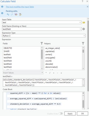

Here is a script to do it in a calculate cell expression here, this assumes that all numbers needed to calculate the stdev are in the same row:
def calculate_standard_deviation(values):
    mean = sum(values) / len(values)
    squared_diff = [(x - mean) ** 2 for x in values]
    average_squared_diff = sum(squared_diff) / len(values)
    standard_deviation = average_squared_diff ** 0.5
    return standard_deviation
Here is how the calculate field would appear:
Here is the output:
If you are pulling from many different cells, I can change it around to do it another way!
Hope that helps!
Cody
