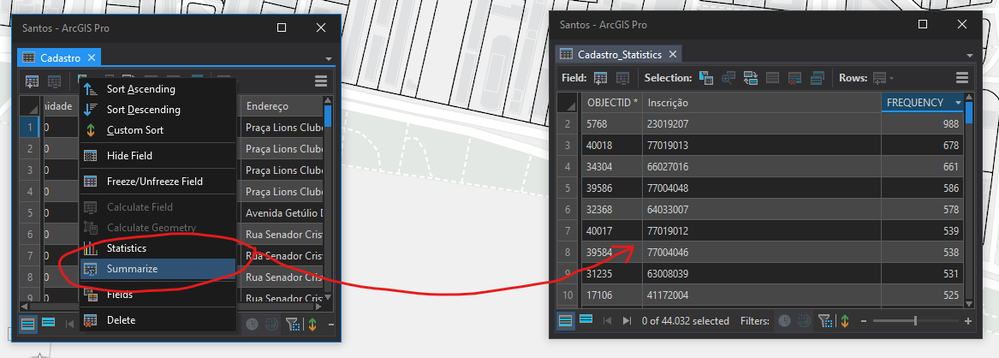

Have you tried using the summary tool on the key column in the many table?
