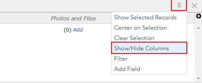

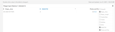

That's a really good method mentioned by David. In case you have chosen "Build a Layer" > Polygons from the templates, Shape_Area and Shape_Length fields are already available (These fields are automatically calculated). You just need to show those fields in attribute table.
You could also Show the Field from Item Details page of the Hosted Feature Layer (Data tab > Table).
In case you see blank pop-up of Shape_Area while creating the shape, keep it blank and close. It will be calculated automatically.

I should also say that these areas are almost useless as the shapefile is created in web mercator.  I'd recommend creating a new attribute expression where:
AreaGeodetic(geometry($feature), 'kilometers')
