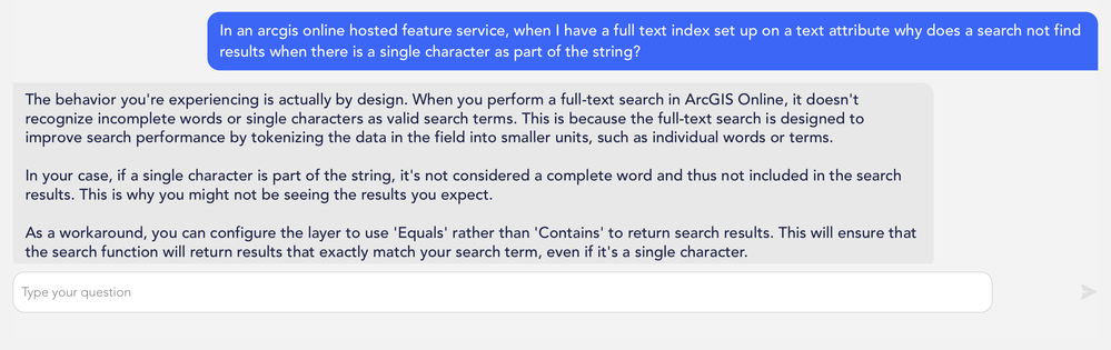

I recently asked the Esri AI Chatbot (in Support app) about the single-character string search problem. It's answer was that the search "doesn't recognize incomplete or single characters as valid search terms." Not sure where the AI sources that but it was an interesting response.
